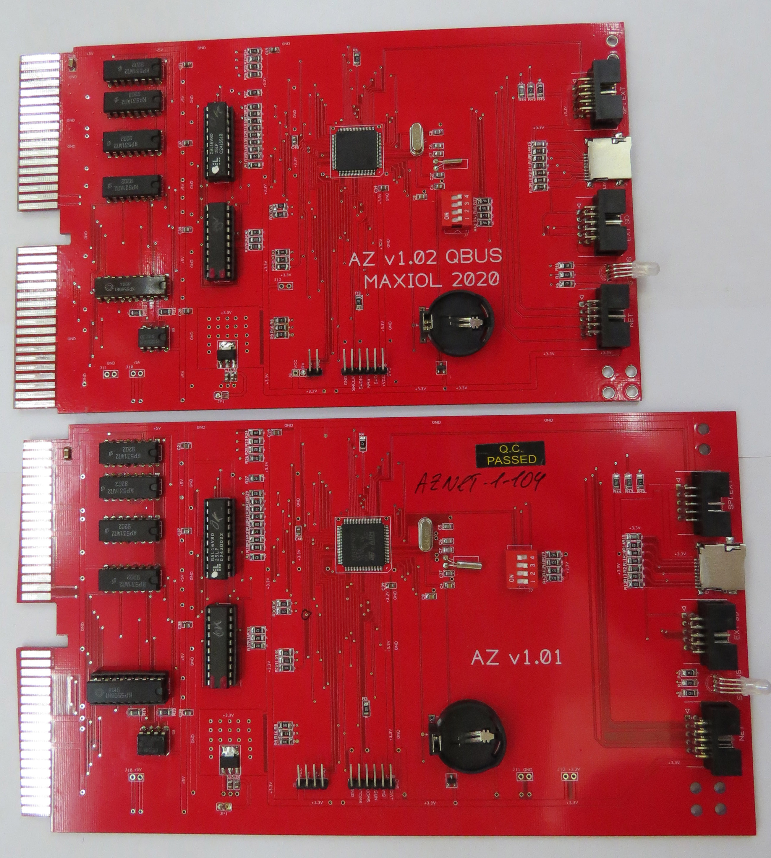

Us developed a pseudo disk controller on MicroSD
This controller is intended for modern and reliable replacement of KZD (DW) in computers of the DVK-1 series; DVK-2; DVK-3; DVK-4; Electronics-60; Electronics 60M; Slavutich PC-1 and similar PDP-11 compatible.
Photo of the controllers:
from above - for QBUS
from below - for MPI BUS (soviet clone QBUS but of a different size):

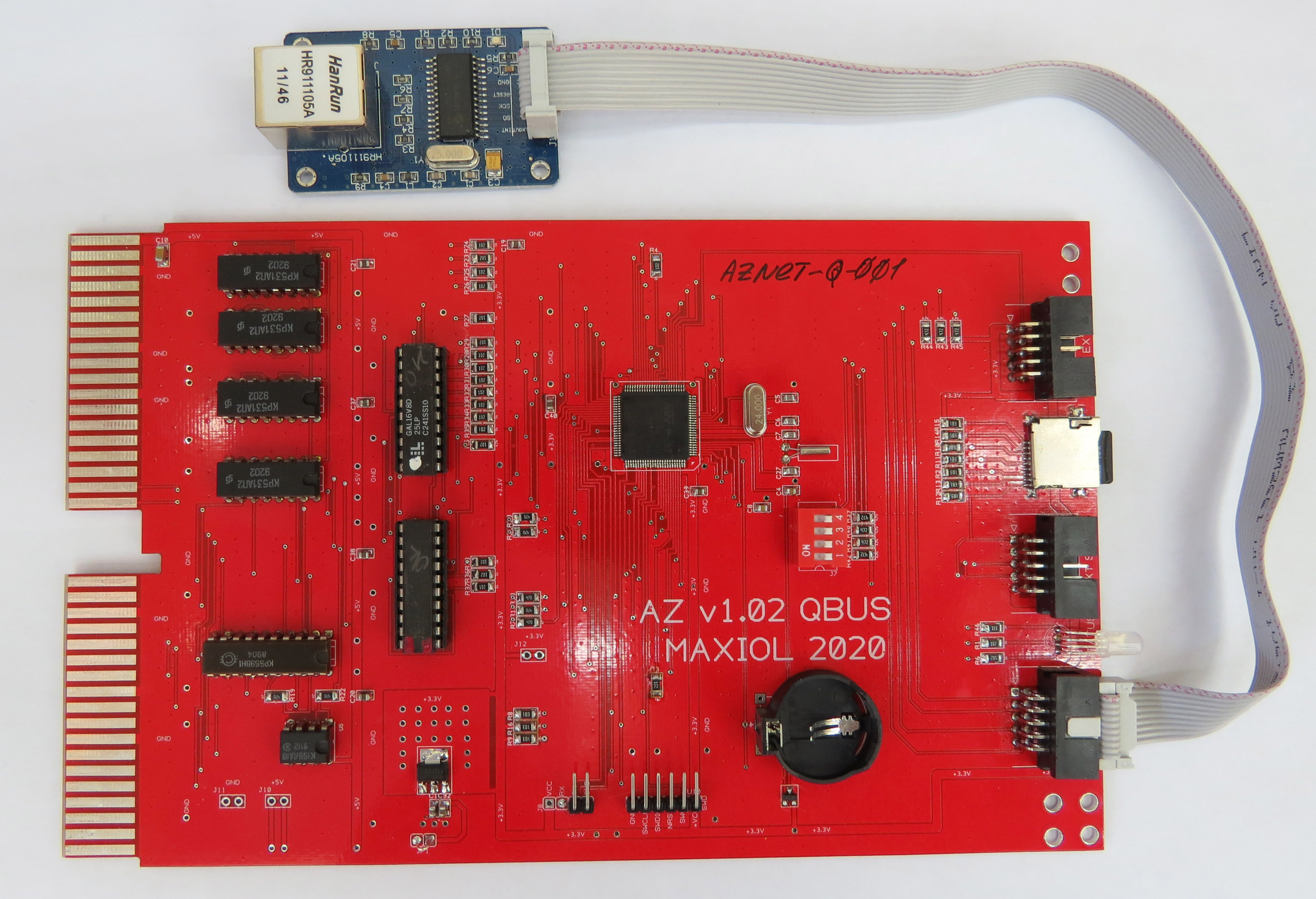

Photo of the controller QBUS with a network card

Connecting the controller to the network
AZ series controllers for DVK UKNTs, etc. have the ability to connect an external network adapter via SPI interface based on ENC28J60
This Ethernet network adapter allows the controller to be connected to the network at a speed of up to 10Mbit.
To connect you need:
- 10pin connecting cable with IDC connectors, no longer than 20cm.
- Etherent network adapter based on ENC28J60
- network Ethernet cable
- a router or other device / service that distributes an address via DHCP
Desirable
- presence of an NTP server in the network
A ready-made 10pin module based on ENC28J60 is used as a network card
connected by a 10-core loop with IDC 2x5 connectors
