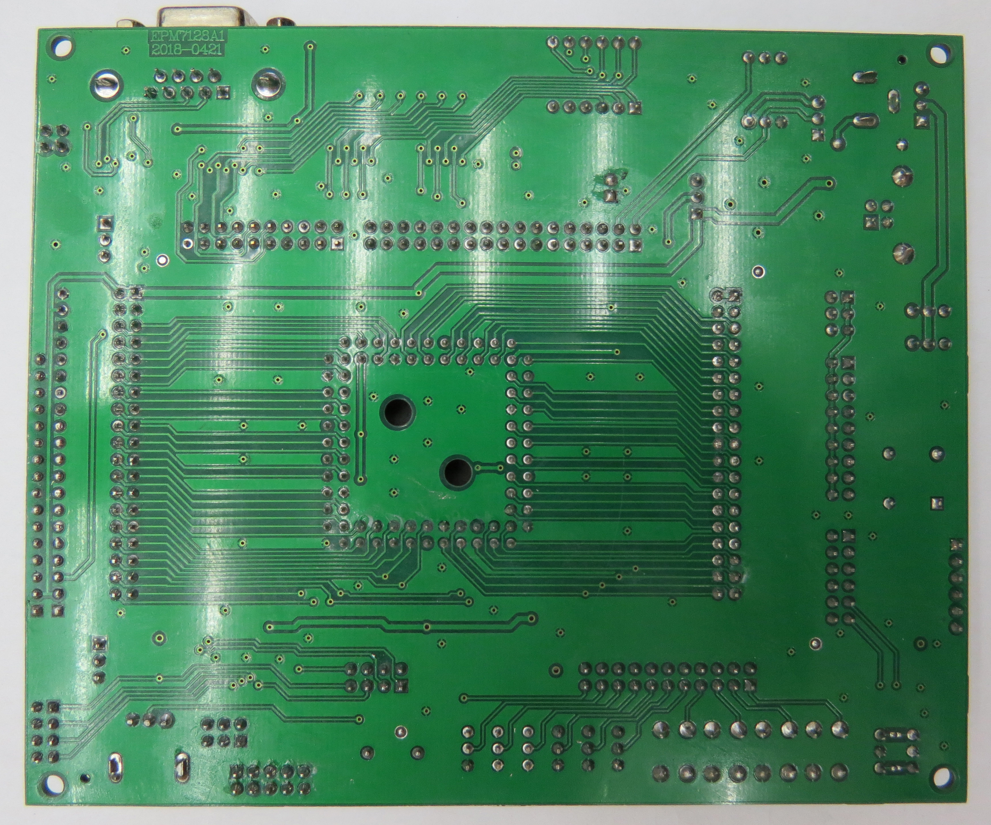

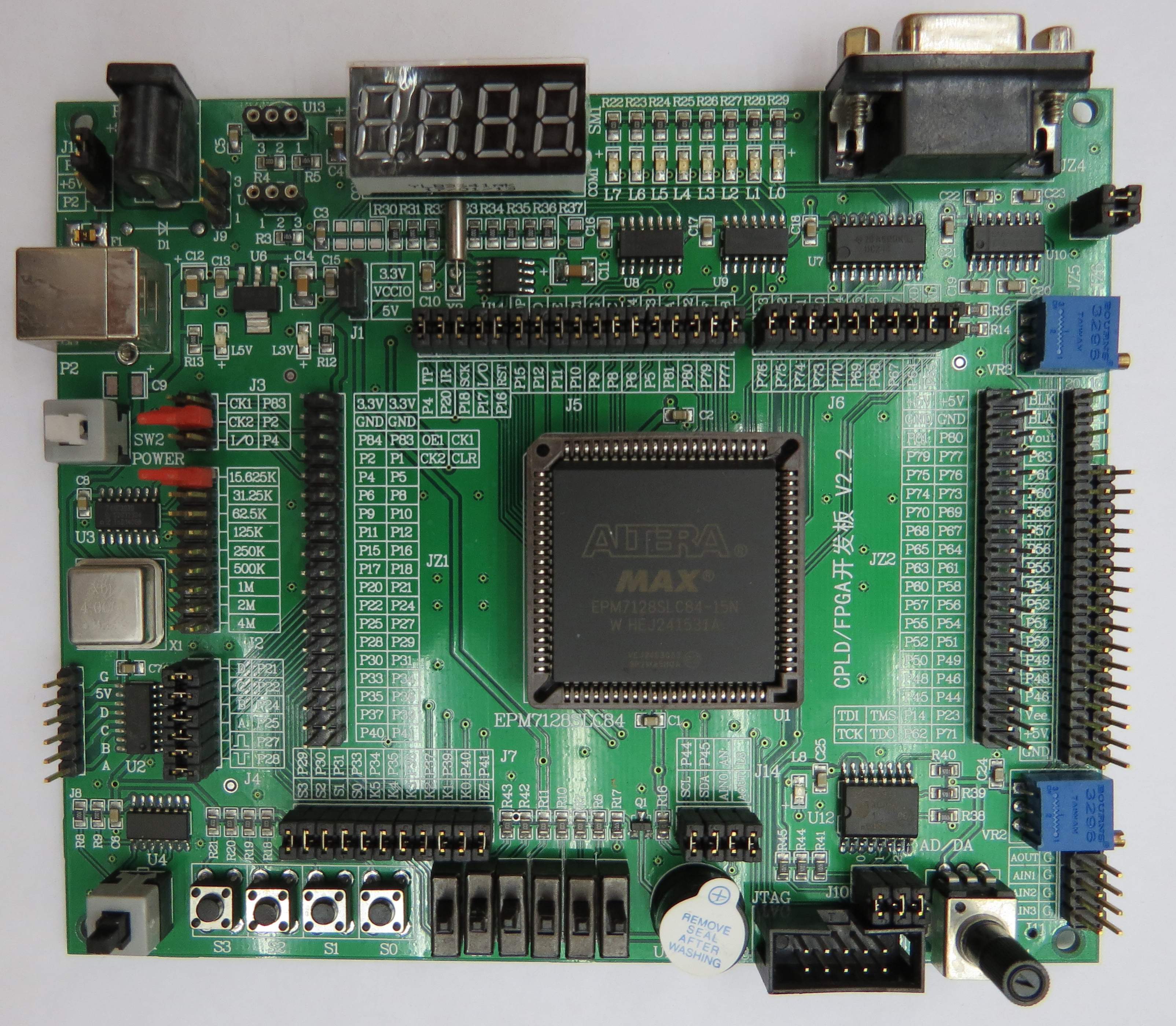

Китайская макетная плата CPLD development board EPM7128A1 v2.2 на базе EPM7128SLC84 FPGA
Прикрепленное изображение

Софт
1. Development board introduction
2, CPLD development board V22 instructions
3. Development board schematic: EPM7128A1_sch.pdf
5. serial debugging assistant V2.1.exe
6. experimental VHDL source program, the development board provides 18 routines.
1. light: the light-emitting two tubes flashing.
2. shift: The LED is shifted to light.
3. ledwater: to achieve a water lamp.
4. PWM: Realize pulses with different duty cycles. .
5. dpyloop: digital loop display 0 ~ F.
6. traffic: implement a traffic light.
7. plus: the pulse count generated by SW1.
8. clock: implement a clock.
9. buzz: buzzer.
10. RS232: Serial port transmission/reception program. With the "serial debugging assistant", receive/send experiments.
11. AD_DA: AD / DA conversion program, I2C program.
13. KS1838T: infrared receiving program, single bus program. .
14. DS1302: calendar clock program, SPI program.
15. LCD1602: 1602 character LCD display program.
16. LCD12864: 12864 graphic LCD display program.
17. CONV: Test procedure for conversion of integers and semaphores.
18. StepCtrol: to achieve a four-phase eight-beat stepper motor speed control program.

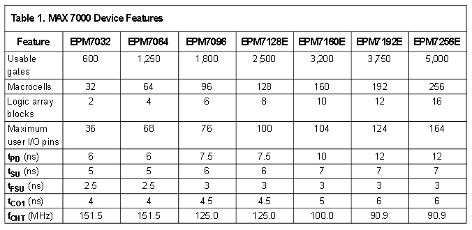

Технические параметры
Серия max 7000s
Тип программирования isp
Количество блоков логических массивов 8
Количество макроячеек 128
Количество вентилей 2500
Количество входов/выходов 68
Напряжение питания, В 4.75:5.25
Рабочая температура,°C 0:+70
Корпус plcc-84(29.31x29.31)
